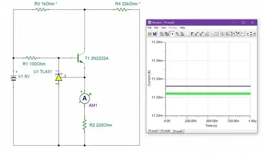

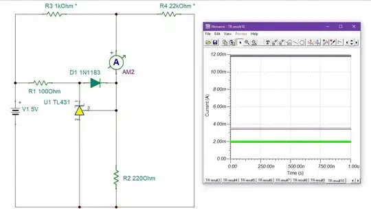

A user already asked a question about it at TL431 Constant current source. My SPECIFIC question is about the figure 29. Sure it is not a complete circuit, so I completed it, in order to understand it, with two resistors, R3 and R4, as place holder for possible "useful circuit". enter image description here And sure, AM1 shows that the current through it is roughly constant (I am using TINA(TM) de Texas Instruments). Also note that AM2 isn't: enter image description here So, the net effect can be accomplished without using the transistor, with a single diode, as shown here:enter image description here

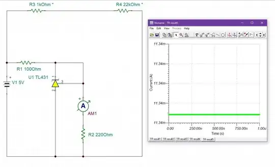

And yes, not shown, but AM1 will still be constant. In fact, if we use nothing, and no connection between R3 and R4, AM1 is constant, as it should.enter image description here
So my question: what is the use of that transistor since it does not help in sinking a constant current between R3 and R4 (which was, I thought, was the purpose of the building block) and since a single diode can do the job ( maybe at a higher expense of energy though ) ?
Note that I varied R3 and R4 with 3 steps each, producing 9 cases, but similar results occur if I use a larger number of steps.

  • Also note that for AM1, we have 2.5 V / 220 Ohm = 11.364 mA working fine, I mean, the model fits the theory on that point. – Michel Walsh Sep 01 '18 at 23:34

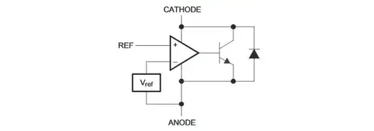

Perhaps you miss-understand the use of the TL431 and how it works. At heart it is a shunt type voltage regulator, an adjustable zener diode. You supply a safe current through a resistor from a voltage source that is within the TL431's safe limits. By attaching resistors or a trim pot wiper to the control pin, and the CW and CCW pins to cathode and anode, the cathode becomes a multiple of the ratio \$(1 + R1/R2{\cdot} 2.50)\$.

The regulator adjusts its cathode voltage to maintain a constant voltage at the reference input. It's like a reference voltage plus an op-amp with a transistor.

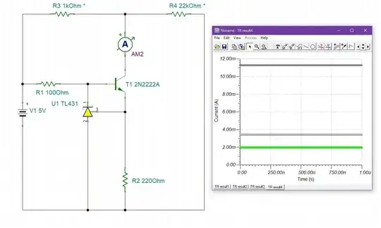

Note that the collector current is what is controlled to be constant. The circuit block is a constant current sink. If you measure the collector current and open up R4 then the collector current should not change (unless you exceed the permissible range of voltages at the collector).
In this case, the current is 2.495V/220\$\Omega\$ = 11.34mA. The maximum load resistance (collector to +5) is about 2.4V/11.34mA = 211\$\Omega\$. When you exceed that resistance you no longer have a constant current sink. So your circuit with 1K is not a useful working example.

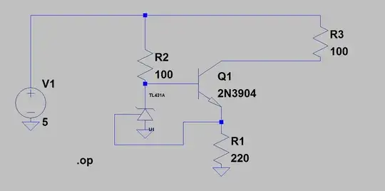

Here is a quick LTspice simulation with a 100 ohm resistor as a load:
Ic(Q1):  0.0113147   device_current
Reduce the 100 ohm resistor (R3) to 0 ohms and we have:
Ic(Q1):  0.0113152   device_current
So it's a pretty good current sink. Output resistance (ideally it would be infinite) is about 2M\$\Omega\$.
Similarly, if I increase the supply voltage to 10V with R3 constant at 100 ohms, I get:
Ic(Q1):  0.0113529
So about +0.06% per volt line regulation. That could be improved by increasing R2. With R2 = 1K the line regulation is improved to +0.01%/volt and load regulation is slightly better too.

  • You are right. I initially though that the sinking current was not constant (when components not supposed to modify it were modified, it was greatly modified too) because the transistor was in deep saturation. – Michel Walsh Sep 02 '18 at 12:02
  • So I tried with a second source, hopefully putting the transistor back in active, or at least, in light saturation, but I was still getting strong variations even putting 12V to the "loop" R3-R4 (instead of letting it connected at the same 5V than for the other components -- no picture included, but available on request). – Michel Walsh Sep 02 '18 at 12:03
  • I re-tried, this morning, putting it at a higher level, and I need around 20V minimum to get to finally get a constant sinking current (with the transistor). – Michel Walsh Sep 02 '18 at 12:03
    So indeed the circuit works, it is just a matter that it is outside the intended range of initial values, and for a typical Raspberry/Arduino project, as you mention, at least where the voltages are "low", the initial resistors are much too large for the circuit. – Michel Walsh Sep 02 '18 at 12:04
  • Yup- or you could say (using my circuit) the ratio R3/R2 is too high. – Spehro Pefhany Sep 02 '18 at 12:45
