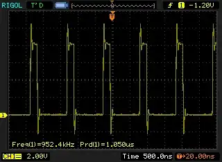

I posted relative problem a while ago here but we came to conclusion that the overshoots were just artifacts. Later, when I extended the signal lines, the overshoots increased and were about 2V of magnitude.

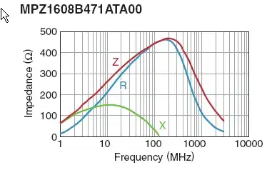

First thing I tried were unknown to me before ferrite beads. I tried several different types of bandwidths but only one had shown some positive effects. I connected one and then two FB in series making a total of 940 Ohms (MPZ1608B471A), the overshoots were smoothed out, but the undershoots remained:

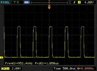

Then I found a similar discussion about my problem here and a simple 100 Ohm series resistor fixed the whole deal:

  1. why a simple resistor (that kills DC as well) fixed the problem, whereas the ferrite bead that should only attenuate high frequencies was not as effective?

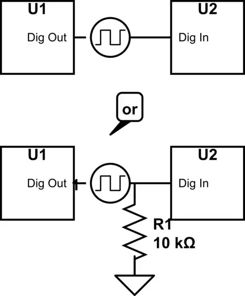

  3. do I need a pull up/pull down resistors if I connect two DI/DO interfaces?

That's not a very high frequency circuit. Ferrite beads tend to be pretty high Q inductors up into the MHz. They get much more lossy at high frequencies.
As you can see from the datasheet, it doesn't cross over into looking more resistive until you hit about 5MHz.

It sounds like your issue is as Wouter suggests, too abrupt of a switching action. From your waveform, it would imply to me that you have a very small inductance action happening. Current starts flowing and then has nowhere to go once it hits the receiver resulting in a transient voltage spike. I'm confused as to why no one has suggested a very small capacitor on the receiver side to absorb this transient energy. If a cap is put in place it should be to ground or if it's a differential signal, between the two signals. This should also help relive your original issue of having cross-talk or transient power issues by smoothing out this signal.
