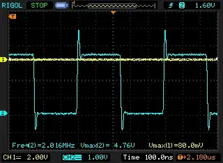

In my experience, even a 1 MHz signal, with about 7 ns rise times, over this distance via a ribbon cable was overshooting by over 1 V (but there was no excessive ringing). The boards will be powered by the same power supply.
Note: You can't see the rise times here but you can see the excessive overshoot - this is a 3.3V signal. And yes, this was measured properly with a very short wire from the probe to ground. Much like it's often recommend on this site. I don't think it's a measurement error.

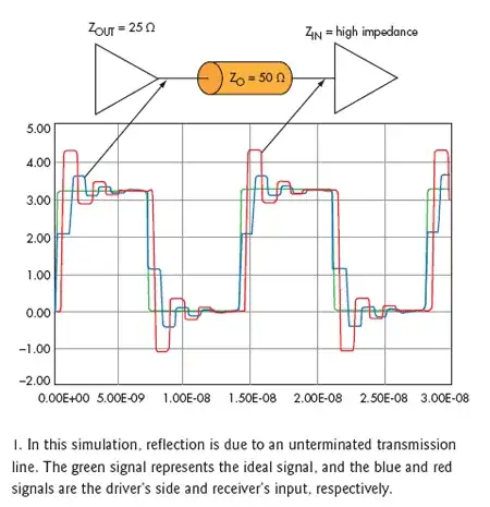

Transmission lines will cause reflections where they show a sudden change in impedance. The reflected signal adds to the original, may reflect again at the transmitter side, and that way go back and forth. The result is shown in the graph: the overshoot you're talking about, and some ringing.
A 12" wire length (30cm) is 1/10 of a 3m wavelength, or 100MHz. 1MHz, and even 4MHz shouldn't give much problems here. Terminating the line, like Wouter says, could be a first measure, though. The input is probably high impedance, and that's never a good matching. Since you have three different pieces in your connection (PCB, wire, PCB) finding the characteristic impedance will be difficult. (It will also be different for the PCB and the wire, so at very high frequencies you'd also get reflections at the cable's connections.) Given the short length and the low frequency the value of your terminating resistor is not critical. 100\$\Omega\$ may be too low for the microcontroller, most of them can't supply 33mA (or even 50mA, at 5V). I would try a 1k\$\Omega\$ resistor to start with, and see how far that gets us.

  • @stevenvh, Tried adding a 1K resistor to ground at the destination. It helped with the spikes but also brought the signal level down a bit. Is that normal? When I say the level where the signal settles down. Also tried 500 Ohms, 220 Ohms same effect but more pronounced. – Saad Jun 06 '12 at 01:25
  • @Saad - How much is a bit? 3.3V in 1k is only 3mA, the driver should be perfectly able to supply that. It may have some internal resistance, but that's a few tens of ohms, so the level should only lower by 2 or 3%. – stevenvh Jun 06 '12 at 04:37
  • @stevenvh I forgot that I series resistor on the line, so obviously I'll drop some voltage. Silly me! However, even a 180 Ohm resistor didn't help much. It brought the overshoot to 4.5V. I'm guessing I'll need a much lower resistance but then I have to worry about current draw. – Saad Jun 06 '12 at 06:49

    I've tried that approach, Olin. I used a 100 Ohm resistor and it dropped the overshoot by about 500 mV and brought it down to 4.3 V from 4.7 V. That's still a volt above 3.3 V! The rise time was then 12 ns as compared to the initial 7. – Saad Jun 03 '12 at 12:20

  • @OlinLathrop I increased the series resistance to 330 Ohms and it brought the overshoot to 3.7V. I'm quite happy with this. The rise time was 10 ns. Should I just stick with this or put in termination resistors on the next revision of the board? I ask because you recommended not to exceed 120 Ohms. – Saad Jun 06 '12 at 07:08
  • @Saad: I was worried about the effect of other loads on the line and it getting susceptible to noise. If the signals are clean and there are no DC loads (just high impedance CMOS inputs, for example) on the lines, then go ahead and use the 300 Ohms. – Olin Lathrop Jun 06 '12 at 11:56
