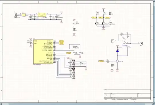

I am having problems with controlling a relay with load on it. I am using PIC16F628A. The problem is following: The relay has load. At first it is off. When the microcontroller's output is on, the relay turns on too. When the relay needs to be shut down, microcontroller's output is off. But when this happens, the microcontroller resets.
EDIT: The load is 220AC. Trying to control bell.
Please note that when there is no load, the relay command fully works, without resetting the microcontroller.

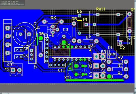

Here are the schematics and the PCB from the project.
Schematics
PCB
P.S. The crystal footprint was changed to capacitor, because I need to draw footprint for crystal, but it has same hole dimensions as the capacitor.

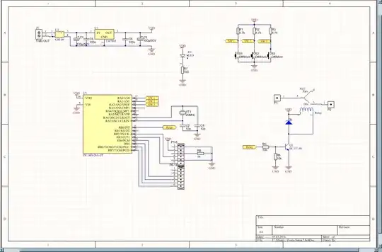

EDIT2: PCB Design was updated as suggested. The Updated Schematics & PCB: Schematics PCB

I had intended to only comment, but I found I had too much to say:
Follow Spehro and Alexey's advice. There are multiple issues here. Perform all of the fixes, even if you find that just a snubber or decoupling capacitor seems to do the trick.
This would seem to indicate that switching the bell is the source of a spike causing the reset. Do not omit the snubber &/or MOV that Spehro suggests since the relay is switching an inductive load. I have seen too many problems with switched inductive loads causing resets in industrial equipment to consider the need for a snubber and/or MOV to be merely a "band-aid". Besides the reset issue, without suppression of the spike, additional arcing will occur on the relay contacts shortening the life of the relay. You can buy a snubber or make your own.
The added decoupling capacitor (suggested by Alexey) needs to have the shortest path possible to the PIC power/gnd pins. The cut-up ground plane does not accomplish this.
The placement of the power/gnd pins on the PIC is a little difficult to accomplish a short path to the decoupling capacitor without either running traces between pads (could require longer-skinnier pads), or placing the decoupling capacitor on the back side.
You could "kludge" the decoupling capacitor to the existing board by cutting the leads short and either soldering it directly to the PIC power/gnd pins on top of the PIC, or soldering it to the pads on the solder-side of the board.
A few more unrelated comments regarding the board layout. Since P1 and P2 are on 220VAC, isolate them to one area of the board with no other traces (even the gnd plane) even close. See Creepage distance for PCBs handling line voltage AC? ... I would also not put the switches too near the AC since fingers will be in there. Also consider adding some mounting holes to the board.

Your layout is not very good (in particular the Vcc path is long, thin and inductive), and that is about the worst relay you could choose (it is about the cheapest, however). A better relay with high isolation (preferably with non-counterfeit European approvals), ground and Vcc polygon pours (you've got Altium, it's a very good and expensive program, you should use those features), and operating the relay from the unregulated input would all help.
PICs are pretty insensitive to mistreatment, but they're not magic.
You could try suppressing noise at the (presumably at least somewhat inductive) load using a snubber or MOV, but that's a band-aid and the problem will probably come back in some way.

Add capacitor 0.1u near pin 14. Pull up PortA5 (pin4) to Vdd.
Alexey
  • 165
    I am having MCLR set to OFF. – Triak Mar 05 '14 at 08:20
    You should take a look at your onboard DC power line (C1 plus pin) with an oscilloscope at a moment of relay turning off. I guess disconnection of the load from an AC line creates an interference in it, and that interference is transfered directly to your MC power supply, causing your MC to reset. – Alexey Mar 05 '14 at 08:57
    And couple more things about layout of your PCB:
    • you must be sure that all of your GND polygons are connected with each other - right now R8 GND edge is floating in the air.
    • rotate P1-6 180' degree - this will allow you to place your VDD line as far away as possible from input DC cirquit.
    – Alexey Mar 05 '14 at 10:26
