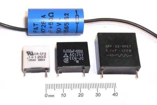

  • As an experiment, try disconnecting the fan from the relay. You need a snubber there to suppress inductive spikes from the fan that can result in arcing across the relay contacts and can also result in resetting of nearby circuitry. See this answer to a similar problem: http://electronics.stackexchange.com/a/101879/25328 – Tut Sep 08 '14 at 15:07
  • When the fan is disconnected, the relay command fully works. Indeed I've the same problem, so I need to put the snubber between from "-" to "+" on the relay power circuit ? – McSIME Sep 08 '14 at 15:14
  • No, the snubber is for the fan and the best location is in parallel with the fan. See the application information in the Red Lion SNUB0000 datasheet – Tut Sep 08 '14 at 15:17
Since your problem goes away when the fan is disconnected, it sounds like your problem is due to the inductive spike caused from switching off the fan. If it were a DC circuit, the solution would be a flyback diode, however since this is an AC fan, you need a Snubber &/or a high-voltage clamp such as a bidirectional TVS diode (transient voltage suppressor) or an MOV (metal-oxide varistor). Besides causing "erratic operation", the inductive spike can also result in shorter life of your relay contacts.
You can make your own snubber or you can purchase one off-the-shelf such as Red Lion SNUB0000. Refer to the Red Lion SNUB0000 datasheet for application information. The best place to connect the snubber is in parallel with the fan.
The snubber alone will probably be sufficient, but if you provide a voltage clamp such as a bidirectional TVS diode or MOV, it must clamp at a voltage greater than the maximum peak voltage of your 230V line. Remember to account for the fact that your line voltage is un-regulated and may go higher, and 230V is RMS (not peak).

  • Thanks for your answer that is really usefull to me ! :) Unfortunately I don't have the components to do the RC snubber by myself... Do the capacity and resistor value or important for this circuit ? (Should 0.1µF and 100ohm be nice ?) – McSIME Sep 08 '14 at 18:10
  • Those components are likely to be fine, however you need to pay attention to capacitor voltage rating and power rating of the resistor. Have a look at this answer by Russell McMahon. For a fan (if not too large) probably a 1000V or higher capacitor (0.1µF. A one-watt resistor will likely be fine). A lower-wattage would probably be OK, but make sure it doesn't get hot. – Tut Sep 08 '14 at 18:49
