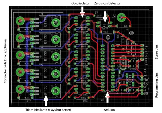

This is the PCB design of the project I have been working on recently (my first pcb design). PCB layout
The idea is to control ac appliances (fans, bulbs etc) without relays. I am using triacs which are better than relays for such applications. I am using opto-isolators for complete isolation from ac lines. I tried running the arduino using USB cable connected to my laptop (with charger unplugged) as well as wall adapter (12V).
At first, circuit seemed to work fine. I was able to dump the code into the controller and control bulbs (On/Off as well as dim them) using UART. I sent the commands via UART. However it seems that whenever there is a spark on the ac lines (when I plug in/out a fan), the micro-controller doesn't look happy. Sometimes it resets (which is the better part of the picture) and other times it hangs and I am unable to send commands via UART. I am not sure whether burnt code gets affected as well but sometimes I had to re-upload the code. If I switch on/off a fan in other room, there is no effect.
Possible issues:
1) Absence of ground plane on the PCB.
2) Some sort of EMI due to sparks.
I also tried plugging in a water heater (800 watts resistive load) the same way as fan but nothing happened. So, I think it's the inductive load which is giving problems.
Any constructive solution for this issue will be very much appreciable.

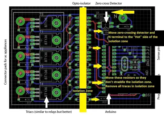

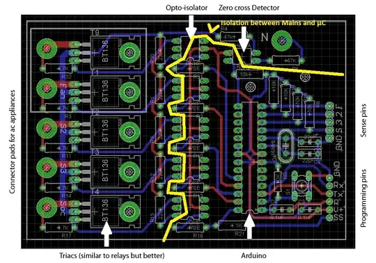

You should respect your voltage isolation. The way you have placed (and routed) resistors R16, R13 R10, R2, R31, and R4 compromises the isolation barrier created by your opto-isolators. Below I have marked your existing layout with your isolation path, which is fairly poor:
Have a single isolation zone that is as wide as possible (the width of your opto-isolators). Keep line circuits on the line side, and isolated circuits on the isolated side. See image below for suggestions.

  • That will be useful, and may help, but do you actually believe this to be the entire source of the problem, and that this solution will completely resolve it? – Adam Davis Apr 15 '15 at 13:11
    @AdamDavis No, I can't guarantee that this is the only cause of problems. In fact, both Olin and Andy's advice should definitely be heeded. However, this is an important safety consideration, and I can also see a less-than-perfect assembly exasperating the issue. – W5VO Apr 15 '15 at 14:34
