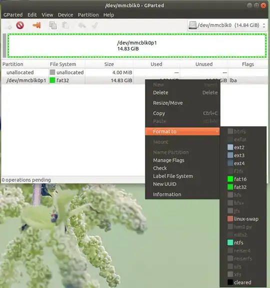

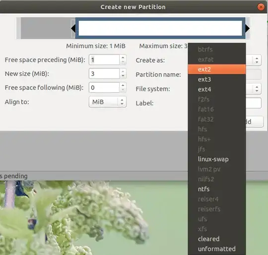

I have installed both exfat-fuse and exfat-utils.
However, when I go to gparted, and attempt to format a partition as exFAT, the exfat option is greyed out when attempting to create or format a partition.
exfat greyed out when attempting to format an existing partition
exfat greyed out when attempting to create a new partition
Why is this so? How can I use gparted to create an exfat partition?

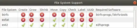

In View->File System Support, exFAT currently doesn't have support in gparted (0.28.1) for anything other than moving or copying.
No "required software" is listed, so it doesn't (yet) know about exfat-utils.
However, because:
  • the partition is a valid partition, and
  • its perfectly safe to move or copy (since the internals of the filesystem are not affected by a move)
the partition must be listed in the list of filesystems, but greyed out in this context.

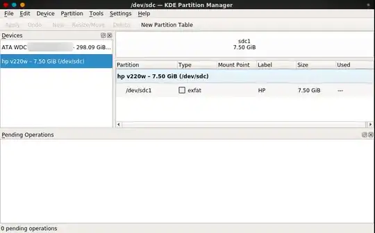

I have the same problem, I didn't understand why it work anymore.
Now am using KDE Partition Manager. It's like GParted but it supports exFAT (still).
Home Page Link: https://www.kde.org/applications/system/kdepartitionmanager/
GitHub Page Link: https://github.com/KDE/partitionmanager
