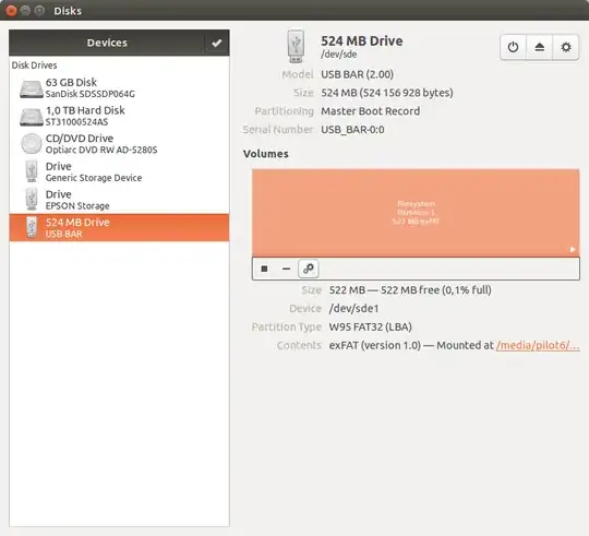

First of all you need to install exfat support packages. You can do it by running in terminal
sudo apt-get install exfat-utils exfat-fuse

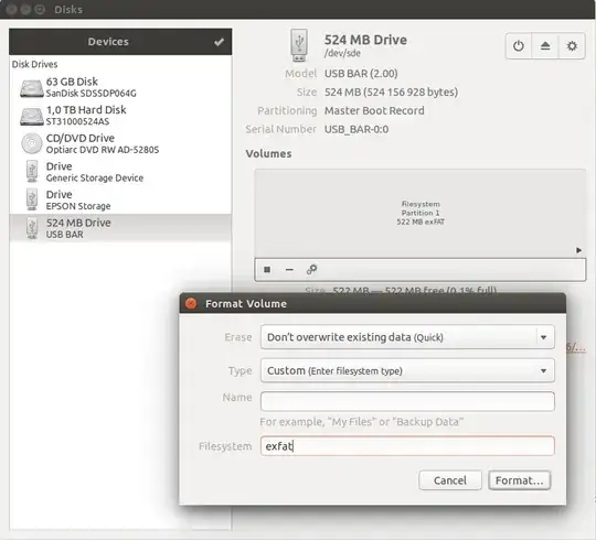

Then you will be able to use gnome-disks to format exfat.
  1. Open "Disks" application in Dash.
  2. Select your disk drive.
  1. Press the "gears" button and select "Format".
  2. Select "Custom" as "Type" and type in "exfat" as a filesystem.
  1. Press "Format".

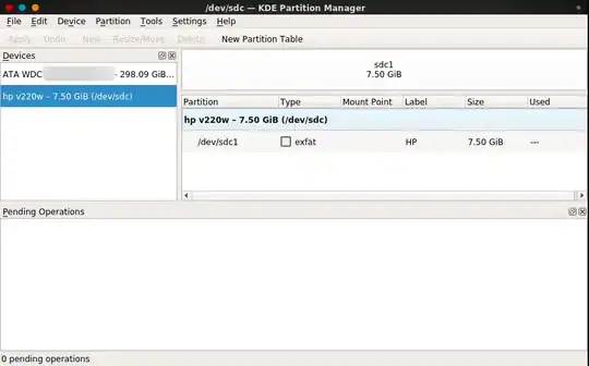

Kde Partition Manager is another alternative to gnome-disks (which I don't have a good experience with when it comes to formatting).
It's Like GParted but (still) have support for exFAT.
I just made a more detailed post about it here.
screenshot
Note
If you're introducing this to a new user, make sure to tell them to use the correct (USB) disk on the right.
