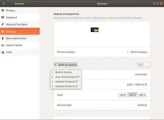

When 3 external monitors are connected, the display settings shows all 3 monitors kinda visible, but not usable:

Vladimir Botka
  • 283
I had the same exact problem - what you need to do is turn the other monitors ON using the slider toggle to the right of the display dropdown (I'm referencing the screenshot of Ubuntu settings from the initial post). Select each of the external displays from the dropdown and toggle each of them ON. You'll likely need to turn the Built-in display OFF if you want to use 3 external monitors.
