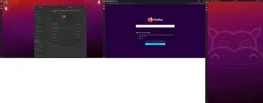

My answer may not be absolutely helpful for everyone, but I was able to succeed. I bought another dock.
  1. Uninstall Ubuntu 20.04, install 21.04 (thanks to a comment of @galexite and @mondotofu -- see above)
  2. Enable Wayland.

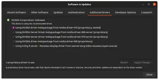

  3. Install nvidia drivers (a lot of people will say not to, but I did it because I have tried many options, they just don't work for my case). nvidia-470 was my choice.
  4. Install Displaylink (yes, even though as of this moment the release is for 20.04)
sudo apt update
sudo apt install dkms
sudo apt install libdrm-dev
sudo ./displaylink-driver-5.3.0.xx.run
  1. Enable thunderbolt (I don't have Thunderbolt -- you're lucky if you have one): I don't know why but my dock (through USB-C Type C Gen 3.2) suddenly works after this.
p/s: I did run sudo update-initramfs -u several times. Overall, my impression is to have the light form of Ubuntu 21.04, and enable Wayland, and then install Display, and then Nvidia. Then things will just click by themselves.

  2. Install nvidia-driver-470
sudo prime-select query
nvidia
