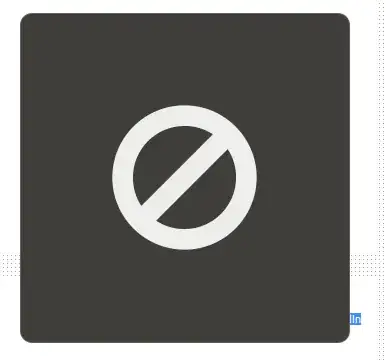

Whenever I'm hitting one of the media keys (play/pause, skip, etc) on any one of my keyboards or bluetooth-headset I'm seeing this icon:
popup on media key indicating no action allowed
flash on the monitor but none of my media players react.
The keys are recognized in showkey:

Now almost every media application that may be waiting for this event (be it VLC, totem, kodi, spotify etc.) expect to receive pure XF86AudioPlay command. And what Gnome does? It intercepts this command and translate it into it's own command "play". Because of this neither xev nor xbindkeys show this event properly - they never receive a command they can understand.
When you press a media button Gnome receives the command and checks if there is any app that its recognized as capable of receiving this command. If there is (let's say totem, rhytmbox, maybe VLC) it sends "play" that should work. If there is no app recognised as capable of receiving this command Gnome will show the sign that is attached to first post and won't send any command anywhere.

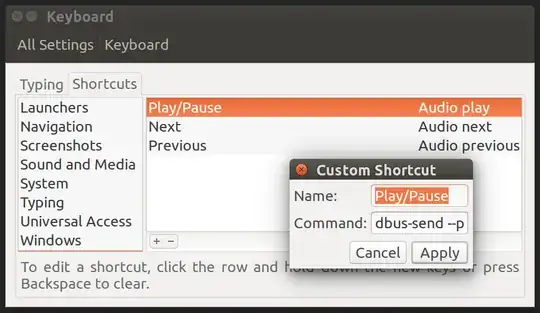

but when I go to Activities -> Keyboard and try to do anything with Play / Next / Previous it not work at all. When I deactivated default key association (invoke dialog for key association, press backspace and click save) and create brand new one it works, very helpful was answer from @foamboarder
now it looks like this screenshot from shortcut setup all works fine now even after wake up the computer from sleep mode

I use Rhythmbox. Here are the commands I was putting for each Custom Shorcut for Rhythmbox:
For Previous:
dbus-send --print-reply --dest=org.mpris.MediaPlayer2.rhythmbox /org/mpris/MediaPlayer2 org.mpris.MediaPlayer2.Player.Previous
For Next:
dbus-send --print-reply --dest=org.mpris.MediaPlayer2.rhythmbox /org/mpris/MediaPlayer2 org.mpris.MediaPlayer2.Player.Next
For Play/Stop:
dbus-send --print-reply --dest=org.mpris.MediaPlayer2.rhythmbox /org/mpris/MediaPlayer2 org.mpris.MediaPlayer2.Player.PlayPause
