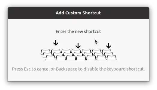

I'm in the process of getting 20.04 setup after having upgraded from 19.04, and part of it is getting my MM keys to work with spotify. While trying to make the custom shortcuts, I have run into a problem. On pre-existing system shortcuts, the MM keys on my keyboard are registered as valid inputs, and can be assigned:
However while trying to assign a keybind to a custom shortcut, the keypress is not recognized, and I am left on this screen:
What I have tried so far:

It's a conflict with Chrome.
When I disable media key support via the config (chrome://flags/#hardware-media-key-handling). I was able to use media keys with Spotify without any additional Ubuntu configuration.
