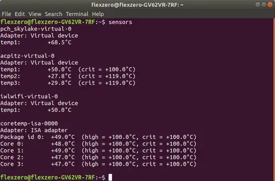

My sensors output:
terminal screenshot with sensors, temp is ~68°C
I have MSI GV62VR-7RF. This is a normal temperature for pch chips; it would be running at the same temperature on Windows. So it's ok for your laptop to have pch on 72 degrees.
>80 degrees is high and >90 degrees is harmful for pch chips.
My MSI laptops's pci is running on almost same temperatures for both windows and Ubuntu. You should not worry about it.
Note: my laptop runs at 70 to 76 degrees pch temperature on boot, while after 1-2 hours it drops to 66-70 degrees.
