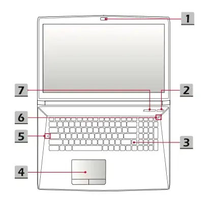

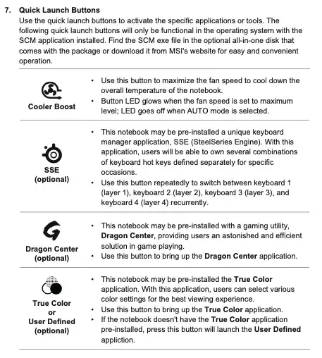

On my MSI GP62 with Linux installed, the cooler boost button makes the right side fan work, which is stopped otherwise, and boosts the speed of both fans.

This laptop uses the Intel HM87 chipset. The mobile version of this chipset does not include PWM hardware so the fans cannot be controlled by the operating system. If any fan control is possible it will be via the BIOS.
The owners manual for the MSI G60 states that some models of this laptop have a "cooler boost" button that controls the fan speed. It also shows that pressing Fn+F5 cycles the laptop through different power management modes.
