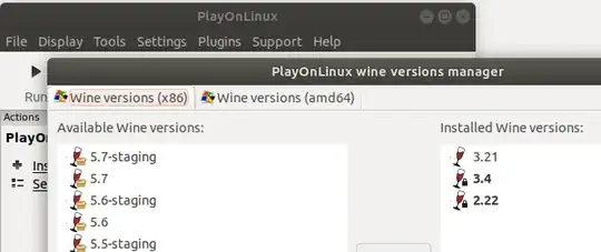

  1. Wine x86 version 3.4 was used for this installation so check if it is installed by starting POL and then selecting Tools -> Manage Wine Versions. Manage Wine Versions window with x86 version 3.4 installed
  2. If Wine x86 version 3.4 does not appear under "Installed Wine versions", then select it from the "Available Wine versions" window and click on the > in the middle to install it. Once installed, close and exit to the main POL menu.

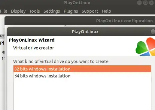

  3. In POL, select Configure to enter the configuration screen and then click New in the bottom left to start the Virtual drive creator.
  4. Select 32 bits windows installation and press Next. Play On Linux 32 32 bits windows installation
  5. Select Wine version 3.4 and press Next.

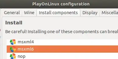

  8. Click on the Install components tab at the top. Then scroll down to select msxml6 and click Install.
POL install component msxml6
  1. Repeat above step to install component riched20.

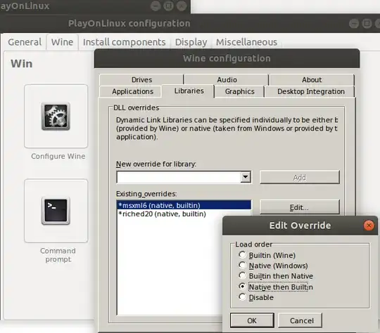

  2. Select the Wine tab in the POL Configuration screen and then click on Configure Wine.
  3. Once the Wine Configuration screen appears, click on the Libraries tab. Click Edit to change both msxml6 and riched20 to (native, builtin). Wine Configuration edit libraries

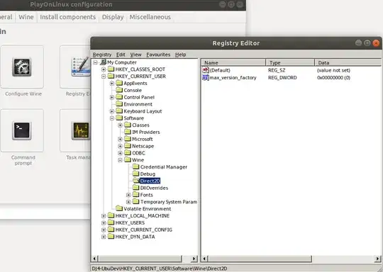

  5. Select the Wine tab in the POL Configuration screen and then click on Registry Editor to open the Registry Editor.
  6. Select to HKEY_CURRENT_USER->Software->Wine and
  7. Click Edit->New->Key and name this key Direct2D.
  8. Select Direct2D and then Edit->New->DWORD Value named max_version_factory with a value of 0.

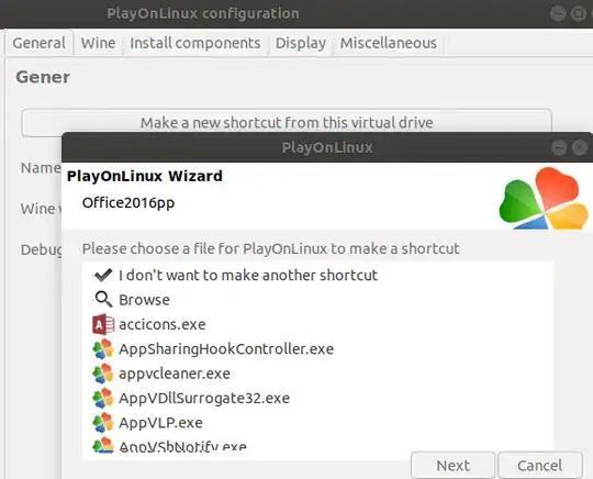

  2. In the Pol configuration screen, click on the General tab and click on Make a new shortcut from this virtual drive to start the POL Wizard in order to create links to the Office apps.
POL create links to apps
  1. You will need to select the executable for each office app and name the link. Note that some of these apps (eg OneNote) may not work at all.
    • Select file WINWORD.EXE and name the link Microsoft Word 2016
    • Select file EXCEL.EXE and name the link Microsoft Excel 2016
    • Select file POWERPNT.EXE and name the link Microsoft Powerpoint 2016
    • Select file MSACCESS.EXE and name the link Microsoft Access 2016
    • Select file OUTLOOK.EXE and name the link Microsoft Outlook 2016
    • Select file ONENOTE.EXE and name the link Microsoft OneNote 2016
    • Select I don't want to make another shortcut to exit the wizard.

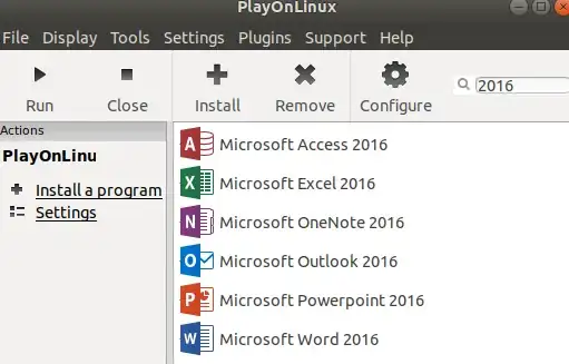

  2. Close the POL configuration screen to exit to the main POL screen. You should now see the apps you now linked to in the main POL screen.
PlayOnLinux with Office 2016 applications displayed
  1. Double click on MS Word inside POL to run it and you will be asked to activate Office. When complete, close Word and close POL.

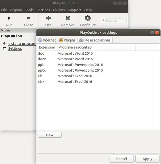

  2. Optional: Update POL's extension file. Start POL and click Setting under Actions on the left side of the screen. Then associate the extensions and programs as shown below.
POL Extensions

POL_Extension_Write doc "Microsoft Word 2016"
POL_Extension_Write docx "Microsoft Word 2016"
POL_Extension_Write xls "Microsoft Excel 2016"
POL_Extension_Write xlsx "Microsoft Excel 2016"
POL_Extension_Write ppt "Microsoft Powerpoint 2016"
POL_Extension_Write pptx "Microsoft Powerpoint 2016"

What worked for me was translating intructions from WineHQ (here) and here to use with PlayonLinux, with Wine 3.4.
  1. Create a new virtual drive
  2. Install msxml6 and riched20 from tab "Install Components"
  3. Configure wine to use msxml6 and riched20 (native, builtin)
  4. Copy the AppvIsvSubsystems32.dll and the C2R32.dll from: /Program Files/Common Files/Microsoft Shared/ClickToRun/ to: /Program Files/Microsoft Office/root/Office16/
  5. Edit registry by adding a DWORD named HKCU/Software/Wine/Direct2D/max_version_factory, set to zero.
For me the script from above (originally by Quentin Pâris, Eduardo Lucio and N0rbert) worked to install Office 2016 Pro Plus under Ubuntu 18.04, with the only changes:
  • wine version 3.0
  • msxml6 in addition to riched20 as overrideDLL
So far Word, Excel, and Powerpoint work, while OneNote and Outlook crashed (don't use them so I didn't even try to fix). Activation worked also, for this open Word -> File -> Account and enter the license key. Here the script, proceed as described above (save as .sh and run under PlayOnLinux -> Tools -> Run local script):

Had to use POL wine 3.14 (latest 3.19 or 3.0 /3.4 did not work for me) on Ubuntu 18.04 and steps 1-5 post Kevin to get MS Office 2016 (Word/Excel/Powerpoint) started. If you download the complete office 2016 IMG file, the installation includes your personal license and is already activated on start.
