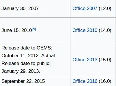

MSOffice version history at the date of this question:

Office 2016, 16.0 - NO.
Office 2013, 15.0 - YES.

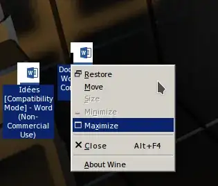

  • Minimized windows are not seen in the task manager, panel or dock, but appear on the desktop as buttons/launchers which show window options when clicked. This may vary depending on the desktop environment, I have only tested in Plasma and Lxqt.
They are a bit annoying as they stay on top of the normal Linux windows. This can be changed by altering the Wine configuration in POL to allow the (Linux) window manager to control the windows.
In this way the windows will then be accessible from task manager/panel as any other window, but this bug would stop you from resizing, moving or otherwise changing the windows' state once you have put them into the "un-maximized" state. So, avoid the un-maximize button.
-- and just use the minimize option or leave the windows maximized and switch them with Alt-Tab or from the panel or dock.
(I do not recommend enabling the other option of running the windows in a virtual desktop: minimized windows would in this case become totally inaccessible.)

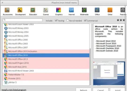

Office 2010, 14.0 - YES
Before installation be sure you have winbind installed:
sudo apt install winbind
  • In Playonlinux 4.2.10 it is listed under ' Install - Office'
