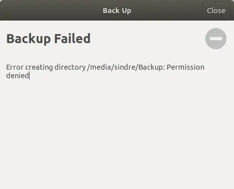

I set up the backup job in Backups, but when I restarted I got the error Backup Failed.

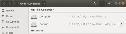

My guess is that the disk was not mounted, and that it only becomes mounted after I go to "Other Locations" and click on the disk (so its mounted like a USB memory stick, and not a hard drive). enter image description here
How can I make sure that my hard drive is correctly mounted so that Backup works? I have Ubuntu 17.10.

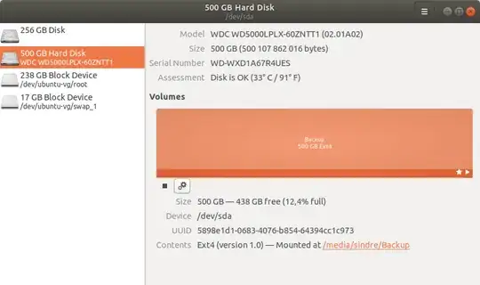

Here is a screen shot of Disks: enter image description here

I noticed/realized that you have wrtten the UUID of the drive in the second edit of your original question. I have edited it, and I suggest the following /etc/fstab file,
# /etc/fstab: static file system information.
# Use 'blkid' to print the universally unique identifier for a
# device; this may be used with UUID= as a more robust way to name devices
# that works even if disks are added and removed. See fstab(5).
# <file system> <mount point>   <type>  <options>       <dump>  <pass>
/dev/mapper/ubuntu--vg-root /               ext4    errors=remount-ro 0       1
# /boot was on /dev/nvme0n1p1 during installation
UUID=0602af3b-b971-4014-91c1-dcb6fe7cec18 /boot           ext4    defaults        0       2
/dev/mapper/ubuntu--vg-swap_1 none            swap    sw              0       0
1. the backup drive from your example (original)
#/dev/disk/by-uuid/5898e1d1-0683-4076-b854-64394cc1c973 /mnt/5898e1d1-0683-4076-b854-64394cc1c973 auto nosuid,nodev,nofail,x-gvfs-show 0 0
2. the backup drive with small modifications from your example
#UUID=5898e1d1-0683-4076-b854-64394cc1c973 /mnt/5898e1d1-0683-4076-b854-64394cc1c973 ext4 auto,nosuid,nodev,nofail,x-gvfs-show 0 2
3. close to what I suggested at first in my answer (select and modify to fit what you need
uncomment alias remove the # character from the beginning of the line that you want to use)
#UUID=5898e1d1-0683-4076-b854-64394cc1c973 /media/sindre/Backup ext4 defaults,noauto 0 2
I suggest that you try example #3, the last line by uncommenting it (remobe the # character from the beginning of the (last) line.
Feel free to try and/or modify any of the three candidate lines, but use only one of them each time. The other two should be 'commented away' with a #.

I successfully just created a backup on my mounted drive following these steps.
  1. created mount point and change permissions (change user3 with your user name)
sudo mkdir /media/user3/my_backup_disk
sudo chown -R user3:user3 /media/user3/my_backup_disk
You should now be able to mount your partition by typing
sudo mount /dev/nvme0n1p5 /media/user3/my_backup_disk
And if you do a ls -la you should see that user3 own the directory
  1. Added partition to /etc/fstab, by adding a line like this (change the UUID with your partition uuid)
UUID=282a0fe8-0439-4023-b8f7-f3edf29267c7 /media/user3/my_backup_disk ext4 defaults 0 2
  1. Reboot and verify that the partition is automatically mounted
  2. Finally set the backup path to the folder you created at point 1, for me is /media/user3/my_backup_disk
  3. Run the backup or schedule it as you wish
