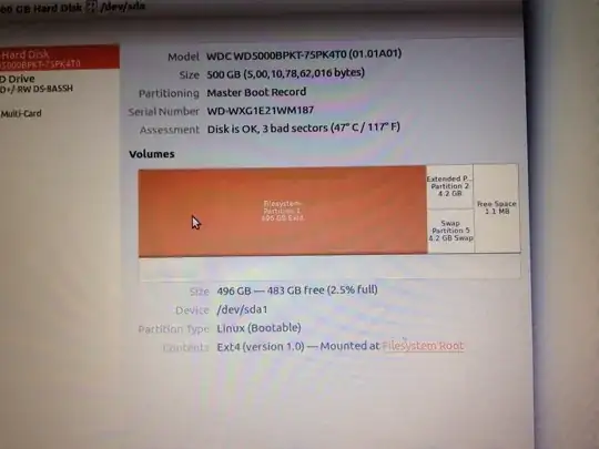

I have installed Ubuntu 16.04 LTS on my Dell Vostro. I wiped out windows and all data and installed only Ubuntu. I want to create drive/folder to keep my personal data like we have in Windows as D and F drives. But I can see only file system that contains Linux file system with 483 GB free space. I want to create folder/drive for my personal data. Please check this image

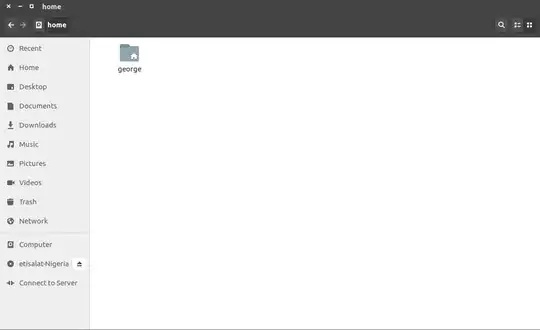

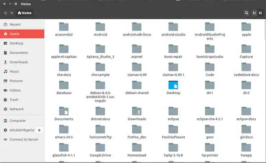

When you launch nautilus you are taken immediately to you home directory as seen here:
So here you drop your personal stuffs.

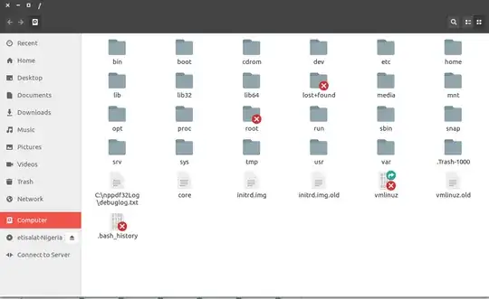

What you have in your image is the HDD containing all your disk partitions. Now click on the name Filesystem Root and you will be taken to the / also known as root as seen below:
Now look at my second image and you will see a folder named home that belongs to you, steps to get to your personal folder:
  1. double click on /home directory
  1. This is your personal folder for all your stuffs, double click to go inside and see all that's there and here you create your folders and files.
All things in Linux starts from / aka root. While in Windows we have several drives, in Ubuntu or Linux we have one drive called root. To make folders [or as you put it - partitions for data] or files personal to you, you do that in the /home/your_username as I have said earlier.
Creating partitions in Linux simply means creating segments on your HDD and these segments can be used to locate any of the folders found in /(root) directory.
Note: No matter where you drop any of the folders found in root, Linux will always present them to you in a virtual manner or filesystem starting from __root_ as seen in my second image.

Because this is your root partition, you should make a bootable USB from Ubuntu CD images (this link help you) and then follow these steps:
  • reboot your system and select USB storage from boot menu in BIOS
  • select Try Ubuntu
  • in unity launcher search Gparted
  • after that Gparted scanning finished, select your root partition and click on resize/Move option and change your partition to any size that you want
