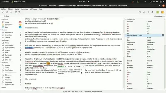

There is also Antidote (commercial software, sold for €119) which supports numbers of applications even LaTeX documents!
Here is a review (in french) using Linux.
Screenshot from the review
