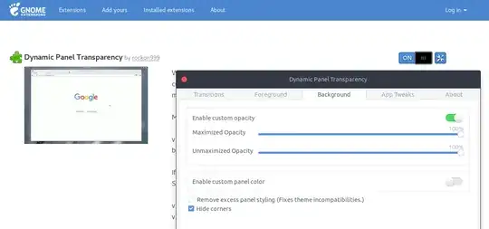

Getting rid of top-bar transparency is a bit tricky. You may use "Dynamic Panel Transparency" extension from here.
Once installed reload the page, a settings icon should appear. Click on it, a dialogue should pop up. Go to Background tab, toggle on "Enable custom opacity" and set "Unmaximized opacity" to a very high value, say 100%.
Then log out and log in again.
