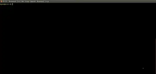

5. Let's play with the script walkr:
  • We can use the command touch file.name -d "1 hour ago" to create an empty file, dated one hour ago. So we can use the following commands to create a directory structure as this presented here.
    mkdir -p ~/temp/dir{A..C} && cd ~/temp ;\
    DEST='';      touch ${DEST}new_file{1..7} && touch ${DEST}older_file{1..7} -d "1 hour ago" && touch ${DEST}oldest_file{1..7} -d "2 hour ago" ;\
    DEST='dirA/'; touch ${DEST}new_file{1..7} && touch ${DEST}older_file{1..7} -d "1 hour ago" && touch ${DEST}oldest_file{1..7} -d "2 hour ago" ;\
    DEST='dirB/'; touch ${DEST}new_file{1..7} && touch ${DEST}older_file{1..7} -d "1 hour ago" && touch ${DEST}oldest_file{1..7} -d "2 hour ago" ;\
    DEST='dirC/'; touch ${DEST}new_file{1..7} && touch ${DEST}older_file{1..7} -d "1 hour ago" && touch ${DEST}oldest_file{1..7} -d "2 hour ago"
  • Now we can perform some tests:
