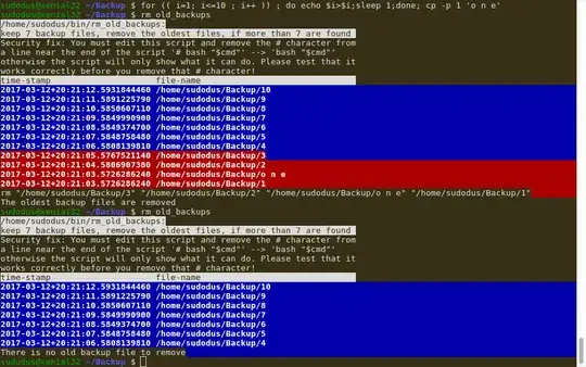

I think @Serg's answer is good and I am learning from him and from @muru. I made this answer because I wanted to explore and learn how to create a shellscript file based on the output from find with the 'action' -print to sort the files according to the time they were created/modified. Please suggest improvements and bugfixes (if necessary).
As you will notice, the programming style is very different. We can do things in many ways in linux :-)
I made a bash shell-script to match the requirements of the OP, @beginner27_, but it is not too difficult to modify it for other but similar purposes.
The following screenshot shows how it was tested: Eleven files were created, and the script (which resides in ~/bin and has execute permissions) is run. I have removed the # character from the line
# bash "$cmd"
to make it
bash "$cmd"
The first time the script discovers and prints the eleven files, the seven newest files with blue background and the four oldest files with red background. The four oldest files are removed. The script is run a second time (just for the demo). It discovers and prints the remaining seven files, and is satisfied, 'There is no backup file to remove'.
The crucial find command, that sorts the files according to time, looks like this,
find "$bupdir" -type f -printf "%T+ %p\0"|sort -nrz > "$srtlst"
Here is the script file. I saved it in ~/bin with the name rm_old_backups, but you can give it any name, as long as it does not interfere with some already existing name of an executable program.
