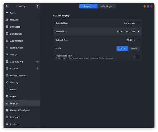

I used to have the same problem and I fixed it just simply by changing the refresh rate in the display settings. Instead of using 60Hz I used 59.96Hz
Display Settings screen shot
