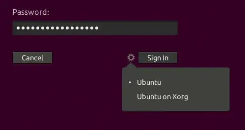

"Ubuntu dock setting is accessible only from the GNOME session(s) customised by Ubuntu, not from the default GNOME session(s).
When you boot your system and get to the GDM login screen you should find a cogwheel (⚙️) next to the sign in button. If you click on the cogwheel you should find an Ubuntu (and/or Ubuntu on Xorg) option.
Choose Ubuntu (or Ubuntu on Xorg) instead of GNOME (or GNOME on Xorg)." ~~ Pomsky
Situation
I had Ubuntu Dock installed but the Dock option was not showing up anymore. Had it before, but don't know when it disappeared.
I verified I had it installed with the apt-cache command below. I did not have a Installed: (none) value but an actual number value.
apt-cache policy gnome-shell-extension-ubuntu-dock
Fix
  1. Restart Linux
  2. Change the session type you log-in with via the cogwheel (⚙️).
    • Choose either Ubuntu or Ubuntu on Xorg.
    • Don't choose some other option like GNOME
In the picture above, I had 3 items to choose from. So I chose Ubuntu and logged in.
If you don't have 3 options, then this solution probably won't work for you. Let me know in the comments otherwise.
