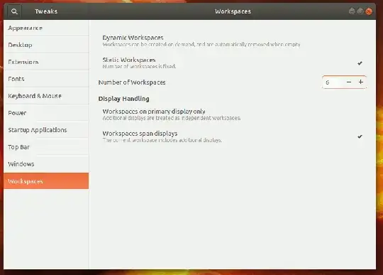

Install the Gnome Tweak Tool:
sudo apt install gnome-tweak-tool
Then launch it
gnome-tweak-tool
Or get to it by searching for "tweak" in the "Show Applications" area.
Bottom left will be a "workspaces" tab where you can tweak your workspaces. I found what I was looking for there.

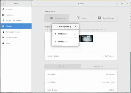

I am not entirely sure if what I will suggest is helpful for the very specific question, but I hope it is helpful to other users.
After upgrading some pcs from Ubuntu Gnome 17.04 to Ubuntu 17.10 with dual monitors, it occurred to me that the monitor order and the primary monitor gets changed from the first monitor to the second.
This configuration can be found in the new Ubuntu in Settings, Devices, Displays:
Ubuntu 17.10 Monitor settings
You can drag-drop to reorder the displays, and there is a small area below labelled 'Primary Display' which is not very obvious that is clickable.
