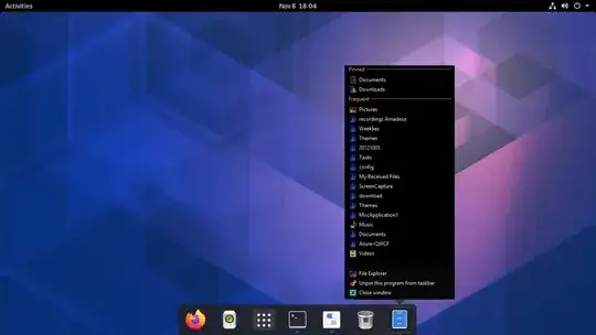

I want like above screenshot for quick access to my file/folder.

Follow the steps below.
  1. Create a .desktop file (say custom-filemanager.desktop) in ~/.local/share/applications. You can do this by running the following command in Terminal
    touch ~/.local/share/applications/custom-filemanager.desktop
  2. Open the .desktop file using a text-editor, for example by running
    gedit ~/.local/share/applications/custom-filemanager.desktop
  3. Add the following lines to the file:
    [Desktop Entry]
    Name=File Manager
    Comment=Access and organize files
    Keywords=folder;manager;explore;disk;filesystem;
    Exec=nautilus --new-window %U
    Icon=org.gnome.Nautilus
    Terminal=false
    Type=Application
    Categories=GNOME;GTK;Utility;Core;FileManager;
    Actions=new-window;open-downloads;
    [Desktop Action new-window]
    Name=New Window
    [Desktop Action open-downloads]
    Name=Open my Downloads folder
    Exec=nautilus /home/YOUR-USER-NAME/Downloads
    Replace YOUR-USER-NAME by your user-name in the last line.
  4. Save the file.
  5. Click on "Activities" and search for "File Manager". It should appear.
  6. Right click on the "File Manager" and select "Add to Favourites". It should be added to the dock.

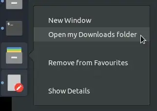

Now if you right click on the newly added File Manager icon in the dock, you should see a "Open my Downloads folder" option which should work as expected.
Similarly you can add shortcuts to other locations by adding new Desktop Actions and adding the name of the action to the Actions= line. For more info see this.

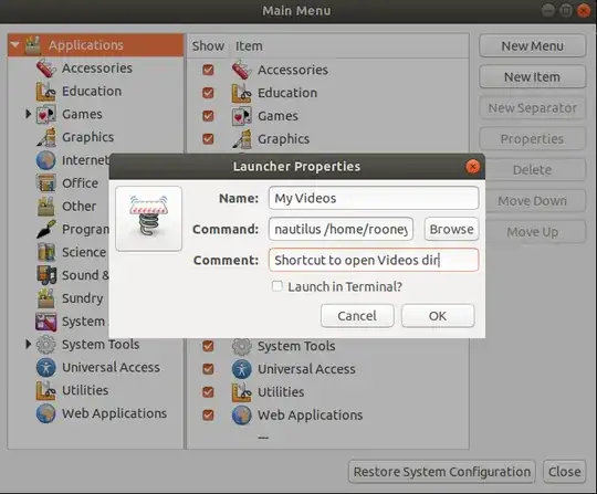

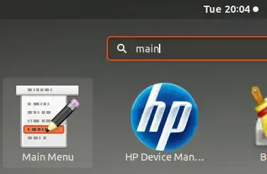

As we can pin only Application to Gnome Dock, the best available option here is creating an application launcher that will open the favorite directory directly with a single mouse click.
  1. So in order to do that navigate to activities and search for "Main menu".
    screenshot
    Now you will get a window titled Main menu.
  2. Click on New item. and You will get a small window and fill the fields like described below.
    In the given example I am pinning my Videos directory to Dock.
    screenshot

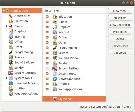

    And now it will be shown at the bottom of the main menu window like this
    screenshot.
  3. Click on close button and again go to activities and search for the the "Name" provided. In my case its "My Videos". Single click on that and just drag and drop it to the Gnome dock.
    Now You will get the shortcut on your Dock.
    screenshot
If you click on that you will get your favorite directory which you set opened by nautilus.

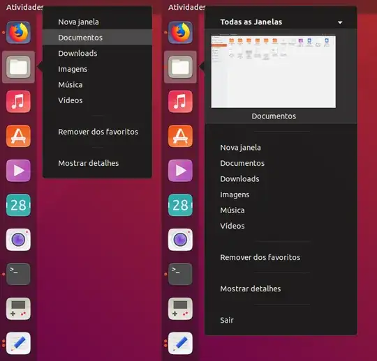

Note: If your system is in another language that not English replace the words of the filds Name= and Exec= of the desired [Desktop Action] for the equivalent in your language. See an example in Portuguese above:
[Desktop Action open-pictures]
Name=Pictures
Exec=nautilus /home/YOUR-USER-NAME/Pictures
Is going to be:
Name=Imagens
Exec=nautilus /home/YOUR-USER-NAME/Imagens
Finally, replace the word of the field Name=Files of [Desktop Entry] according to what Files means in your language. In Portuguese, for example, Files is translated Arquivos, so I had to change Name=Files to Name=Arquivos. If you don't do this, you'll end up with two Files icons with different names in your computer.
Final result

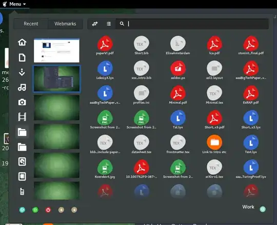

It's not prefect for what you seek, but you might be interested in the Gno-Menu extension.
The extension adds a quite configurable menu. The following shows it's default:
The recent documents I have accessed are shown on the right. The shortcuts on the left are set to the Places of Nautilus. The highlighted folder shortcut is to a folder I have "pinned" in Nautilus.
The Recents overview does not seem to support viewed folders. I don't know how the "Link to Intro etc." link got in there. Creating a new link to a folder and opening it did not put the folder there, and roaming in Nautilus does not affect Recents (until you open a file).
The right-hand side can also be configured to show your Favorites from the overview, where you could then add .desktop entries for Nautilus to open specific folders. (See pomsky's answer, but use Exec=nautilus /home/user/folder/ --new-window %U and include only the [Desktop Entry] part.)

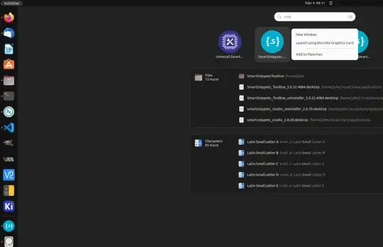

In Ubuntu 22.04 (Gnome 42.4) you can easily pin your application from Dash search:
