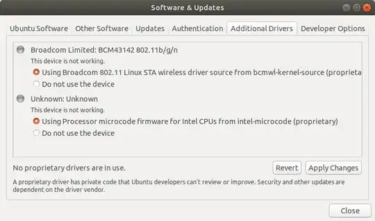

Ok I found it, it is hidden under Software & Updates.
Another way to install drivers is:
sudo ubuntu-drivers autoinstall
