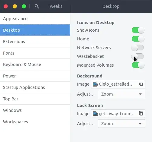

You may use (GNOME) Tweaks (aka GNOME Tweak Tool) to do that. First install it (if it is not installed) by running the following command in Terminal
sudo apt install gnome-tweaks
or
sudo apt install gnome-tweak-tool
Launch Tweaks and go to Desktop section. Then toggle off (or uncheck) the Trash (or Rubbish bin or Wastebasket) option under "Icons on Desktop".

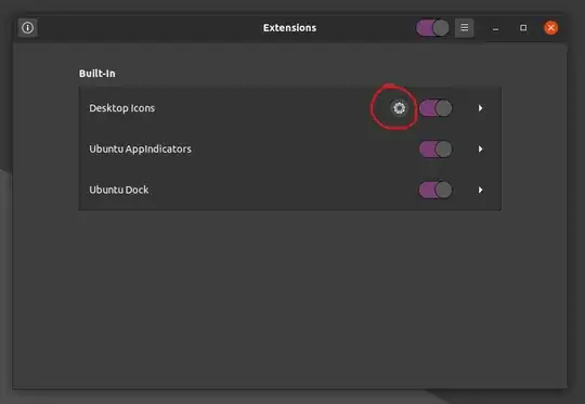

It is actually easy:
  1. Search for Extensions (preinstalled) in the Activities overview.
    Search for Extensions (comes installed ready)

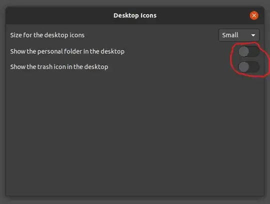

  2. Click on the Settings gear icon next to the Desktop Icons toggle
    Click on the settings gear icon next to the Desktop Icons toggle
  3. Toggle icons as required

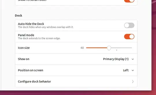

Ubuntu 22.04
Right click on the Desktop space and select Desktop Icons Settings enter image description here

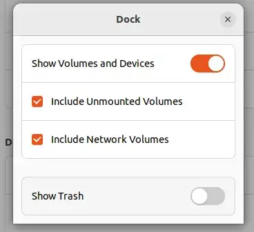

Find Configure Dock behaviour section enter image description here
Toggle Show Trash button
