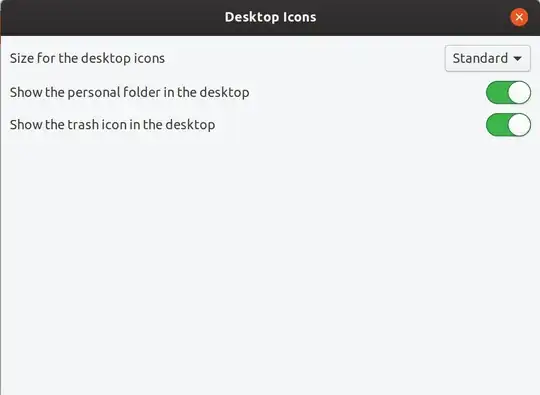

Ubuntu 19.04 and later
Disable the trash icon option from Extensions > Desktop Icon in Tweaks:
enter image description here Alternatively, run the following command (note that this does not work from 21.04 onwards)
gsettings set org.gnome.shell.extensions.desktop-icons show-trash false
