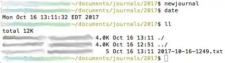

Here's a screenshot of what I'm trying to explain. Here I create a newjournal, save in nano within a second or two of executing the command, print the correct date/time, list the file that was created. Note the incorrect filename time (1249, as apposed to 13:11):

The date commands are evaluated when you declare the alias.
