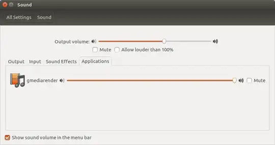

  1. Install and run gmediarender on Ubuntu from the command line.
    sudo apt install gmediarender
    gmediarender -f <Name>
    Consult the manpage for more options.

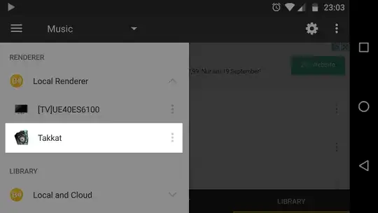

  2. Install and run Bubble UPnP on the Android device.
  3. Search for the renderer name you gave in Bubble UPnP > Local Renderer
  4. Select tracks to play on the Android device and listen to them on the Ubuntu machine.
