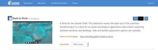

  1. Go to Dash to Dock's homepage at extensions.gnome.org.
  2. Turn the extension on by clicking on the toggle button.
  3. Reload the page. It should look like this:

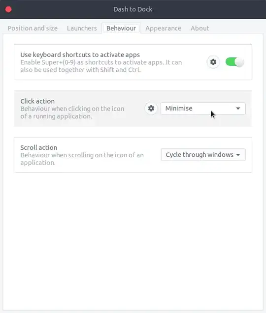

  4. Click on the "settings" symbol next to the toggle button which now says "ON". A window should pop up.
  5. Navigate to the "Behaviour" tab and select "Minimise" in "Click action".

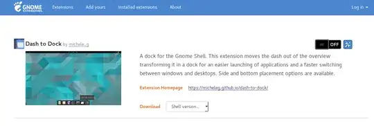

  6. Close this window and come back to Dash to Dock's homepage.
  7. Click on the toggle button to deactivate Dash to Dock.
Now clicking on the icons of running applications in Ubuntu Dock should minimise/restore the focussed application window.

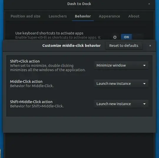

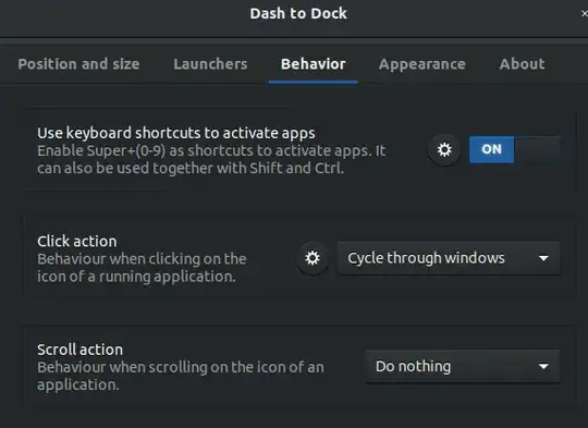

I will say that the best way is not to change the action to minimize. Just live it as it is. Instead, if you look at this Navigate to the "Behavior" tab and select "Minimize" in "Click action". Next to the click to action you will see a gear icon.
A new window should popup (Customize middle-click behavior) there you can see on the first option that Shift+Click already is set to minimize the window. So you can leave all default and when you want to minimize the do Shift+Click.
I recommend this because there are other post where people gets annoyed with the result after they change this behavior and then want to reverse it because this does not work properly when you have multiple windows open.
Here is a screenshot of the screen that I am referring to:https://i.sstatic.net/LqHzs.jpg
Step one Click on the settings next to the on button enter image description here
Step two click on the Behavior tab enter image description here
Step three click on the gear icon next to the Cycle through windows
Step four look at the first option that indicates to use Shift+Click enter image description here
Using this will allow you to get the functionality you desire without having the issue that other are complaining about when it come to multiple browser windows open.
