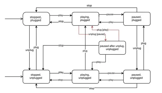

This state machine describes the desired operation: Unplug-pause FSM
The one idea that came to my mind is to re-bind the keyboard shortcuts for play / pause / stop to add the state machine logic. This has the drawback that playback always has to be controlled using these keyboard shortcuts, instead of eg. Rhythmbox buttons, which is somewhat impractical.
