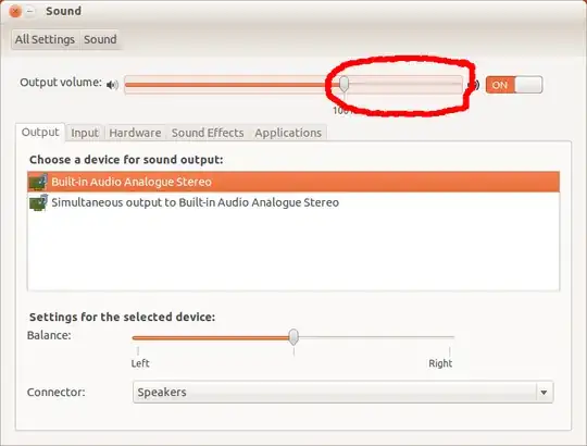

Somtimes some sound/movie/music on my Ubuntu_12.04 system is at a very low volume by itself. Henceforth I increase the volume of the sound output. I can use the following setting (see screenshot) enter image description here
It seems therefore that pulseaudio is able to increase the volume beyond the maximum that appears possible by merely using the "increase-volume" buttons of the machine. My questions is how I can adjust Pulseaudio to allow a greater range or a higher max volume increasing???
