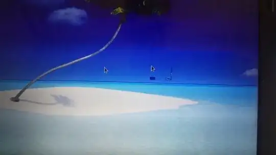

The system freezes randomly, the keyboard stops working, the screen freezes and there will be a second mouse pointer that can sometimes still move around, if music is playing, it continues normally for a little while then it starts repeating the last second indefinitely. Sometimes some weird pixels appear on the screen like on this image:
At first I suspected the problem might be related to gnome since it appeared to happen only when I interacted with the file system, but recently it's been occuring quite randomly so now I suspect it's related to the graphics driver.
