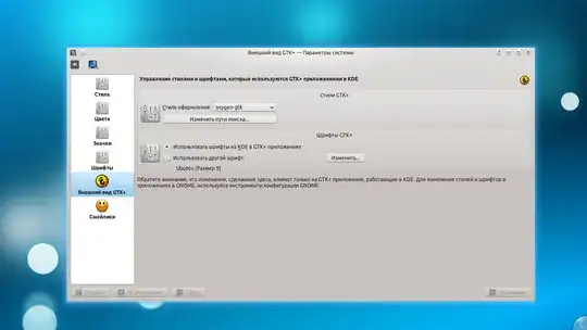

GTK+ in Kubuntu apps look bad
and configure all by recommendations
but oxygen-gtk theme does not affect the appearance

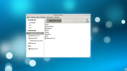

This application on the first screenshot is probably using GTK3, while the original instructions only apply to GTK2. I posted over there a link to a site that gives instructions for fixing GTK3. I'm not posting here too because I'm not sure if this would be considered duplication.
