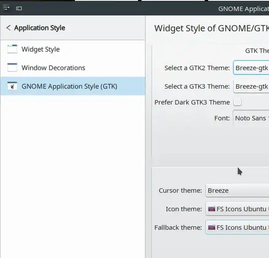

Old question with old answers, but maybe still interesting - and appearing in internet searches anyway. So, for the record:
In KDE/Plasma5, there are GTK settings in the System Settings, Application Style:
piovisqui
  • 241
