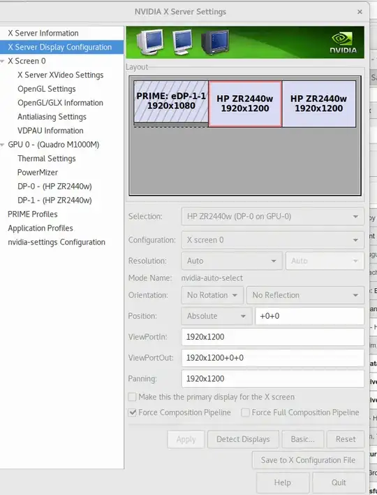

If you want to use hybrid graphics, or if you have no choice, it is easy to avoid tearing on external monitors since they are driven from the nvidia hardware. Is the tearing only on the laptop panel, or on external monitors? External monitor tearing is fixed by force pipeline composition, in my experience of the two machines. Full pipleline is not needed. This is solution (2a) but it doesn't stop tearing on the laptop panel. You can turn it on from the nvidia control panel or via the command line (good for a start-up script). See screen shot below. There is a trick: you need to select an external monitor, not the internal panel, and then click Advanced... A command line script is below.

So to elaborate on getting no tearing in hybrid nvidia mode: In this mode the nvidia card renders everything. It can write directly to external screens, so any tearing on external screens is just an nvidia problem. ForceCompositionPipeline was the fix I needed.
You can activate this from the command line. Here's what I do.
#!/bin/bash
nvidia-settings --assign CurrentMetaMode="$(nvidia-settings -q CurrentMetaMode -t|tr '\n' ' '|sed -e 's/.*:: \(.*\)/\1\n/g' -e 's/}/, ForceCompositionPipeline = On}/g')" > /dev/null
I am not the author of that snippet, too magical for me. You can also do this from the Nvidia control panel Advanced, but make sure you click on the representation of the external monitor. The PRIME panel, that is, the laptop panel, does not show this setting

A shorter answer based on answer by Tim Richardson. For systems with Skylake processor and nVidia GTX 970M controlling HDMI. Clean install of Ubuntu 16.04 and do none of the other steps in the answer, simply use Dash to launch NVIDIA X-Server Settings:
NVIDIA x-server settings
Click the Advanced button to make Force Composition Pipeline option available. Then check it and apply changes.

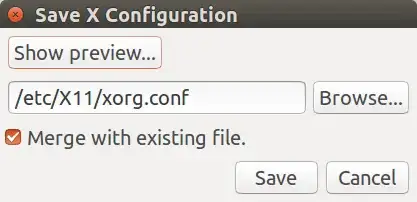

Note there is an option to save the configuration file:
nVidia X Server Settings save
The next step to make your Screen Tearing fix permanent is detailed in ArchLinux. In a nut shell:
