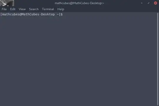

First open a terminal.
There is many way to do this. This method is the simplistic. Press Alt + F2 on your keyboard. You will see a dialog box come up and type in gnome-terminal or the name of your terminal. It should look like this now.
Dialog1
Now, press Enter. It should close and bring up an terminal.
Blank Terminal

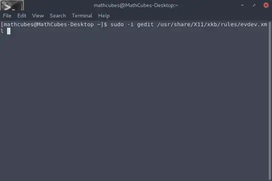

  1. Now type in
    sudo -i gedit /usr/share/X11/xkb/rules/evdev.xml
    This is how it should look.
    Terminal with filename1

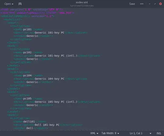

  2. Now, press Enter and it should open the file in which we need to edit. This is how it should look:
    Gedit_1

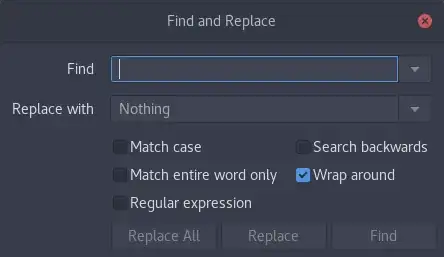

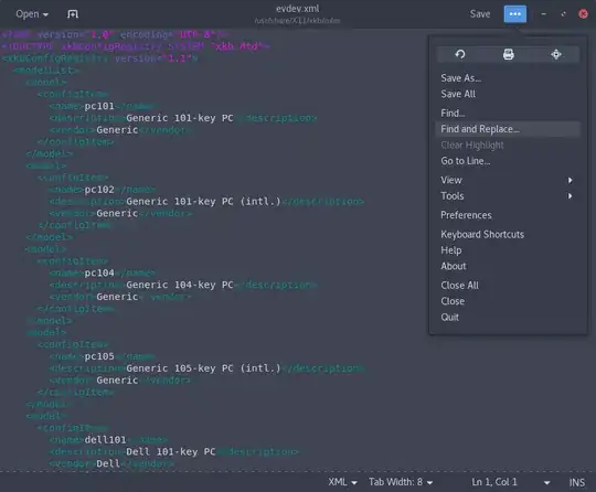

  3. Now click on the bottom with the three dots. Highlighted in blue, then find and click on "Find and Replace..." Highlighted in lighter gray.
    Now it should bring up an dialog
    Dialog_2
  4. Now we can edit this file to change "en" to "Eng". This will change all of the layouts that uses "en"
    Now, type into the text-box with "Find" to the left of it with this <shortDescription>en</shortDescription> Next, with the textbook below it and text to the left that says "Replace with", type this in it <shortDescription>Eng</shortDescription>. Now it should look like this.
    Dialog 2

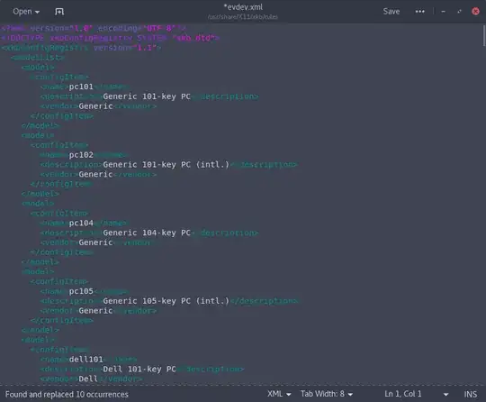

  5. Now click on the button that says "Replace all" now that dialog box should disappeared with it saying it's found and replace 9 or so occurrences.
    Gedit_2

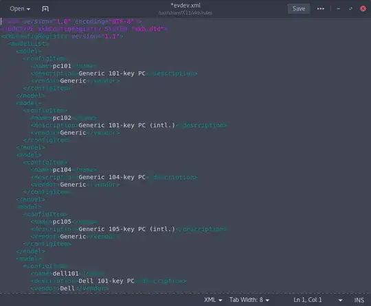

  6. Now save it by clicking on the save button highlighted in light gray.
    Gedit_4
    Now, notice that the asterisk in the title should go away like this. If it didn't then it didn't save.
    Gedit_1
