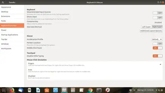

  • gnome-tweak-tool > Keyboard and mouse > Switch between overview and desktop offers only 2 options:
    1. Left super, Default
    2. Right super
    Switching the option to 'Right super' should do the trick.

An update to faux-sho's answer you can now disable it using gnome-tweaks. You will have to install it using the software center.
Open it by searching for "Tweaks", and navigate to Keyboard & Mouse -> Additional Layout Options -> Alt/Win Key behaviour and select "Meta is mapped to Win".
