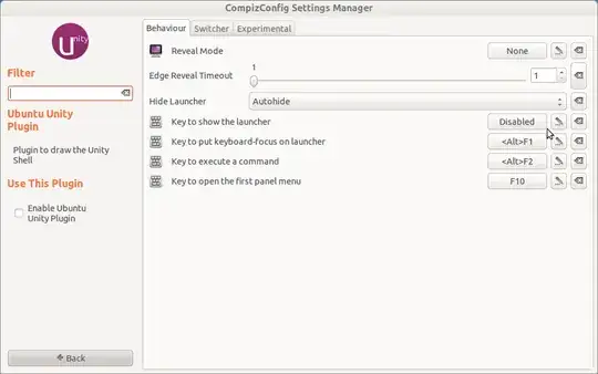

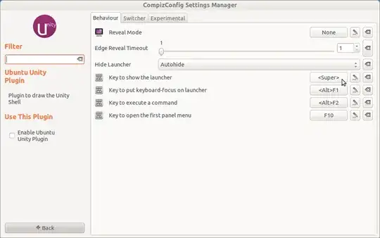

You can change that in Compiz.
  1. Install compizconfig-settings-manager
    sudo apt-get install compizconfig-settings-manager
  2. Hit Alt+F2, type about:config and hit Enter to open the Unity configuration.
    Or run ccsm on the command line.
  3. Change or disable the shortcut for Key to show the launcher as you like to free your Super key:
