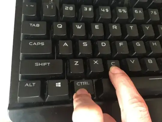

I've followed the instructions here to switch my Alt and Ctrl keys. Now when in a terminal I want to press the physical Ctrl+C to cancel. But the new mapping means I physically press Alt+C.

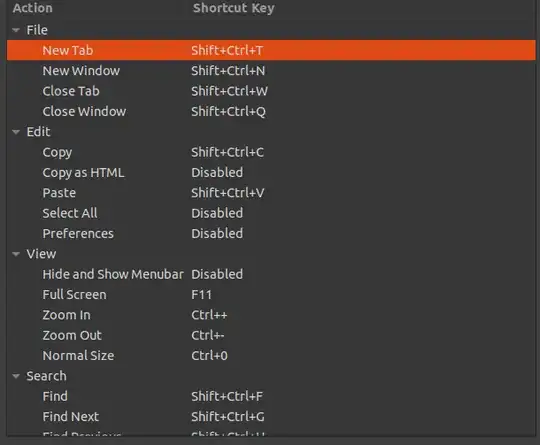

I looked at the keyboard shortcuts for the terminal: enter image description here
and can't find that shortcut there.

Finally, if it helps to understand my motivation for wanting to do this: right now, under my key mapping I have to physically press Shift+Alt+C to copy from the terminal, whereas in every other app that I use I just press Alt+C. After months I still can't get the hang of mentally adjusting. I end up pressing Shift in my other apps, or cancelling things in my terminal by forgetting to press Shift in the terminal. It's driving me insane!
Another point on my motivation. I'm coming from being a mac user, where in the terminal you have to press physical Ctrl+C to cancel, and physical Cmd+C to copy. On a standard non-mac keyboard, the Cmd is in the same place as the Alt. That's why I've done my key mapping this way.

  • You can change other shortcuts in Terminal, they are shown in the shortcut menu on your question.

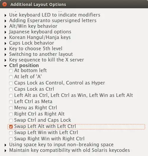

Swap Ctrl and Alt systemside.
First reassign the Ctrl and Alt as you describe, using xmodkey or Gnome-Tweak Typing setting
Tweak
I believe you already did this. Many other ways introduced
setxkbmap -layout 'us,us' -option 'ctrl:swap_lalt_lctl'

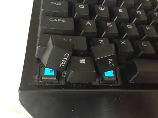

Some keyboards are not allowed to replace keycaps, e.g. HHKB Pro cannot be done due to the different unit size.
However, most of keycaps are physically swap-able.
swap
