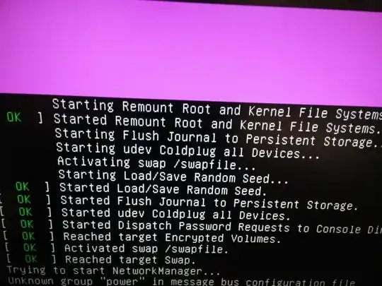

Running UbuntuGnome 17.04 I am not enable to start networking in recovery mode, because there is an unknown group "power" in message bus configuration file error when NetworkManager is trying to connect. NetworkManager won't connect.
I am using a Wireless Lan Adapter: Bus 003 Device 004: ID 0bda:8172 Realtek Semiconductor Corp. RTL8191SU 802.11n WLAN Adapter. enter image description here In an older Version of Ubuntu Gnome it was possible to enable networking using this adapter.
EDIT:
I could solve the 'unknown group "power" in message bus configuration file' error due to cd /etc/dbus-1/system.d and find . | xargs grep 'power'. It showed up that thermald seems to not work properly. Purging it temporarily the error was not shown up. But NetworkManager didn't connect as well. Running root from recovery it tells me that nmcli can not be found. But it is installed and works properly running the system in graphic mode as user. Any ideas how to solve this?
