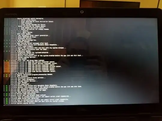

I decided to update to 20.10 and it appeared to go smoothly. However, after I rebooted all I could see was this:
/dev/sda5: clean, 764403/30498816 files, 30197898/121964800 blocks
Not sure what happened, but when I press the power button, it instantly starts shutting down, including showing the graphical splash screen.

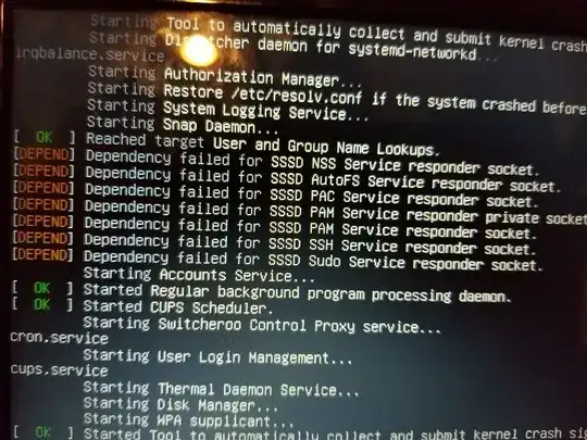

At startup, I do see my graphical boot splash. When pressing Ctrl+ ESC, I can see the startup terminal with a few dependency errors...
dependency errors
I'm not entirely sure what to do next... keys do nothing, but Ctrl+Alt+F1 briefly shows the startup terminal, then shows a blank screen with a text cursor. I still can't do anything.
What should I do next?
