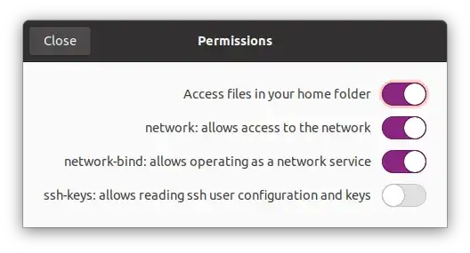

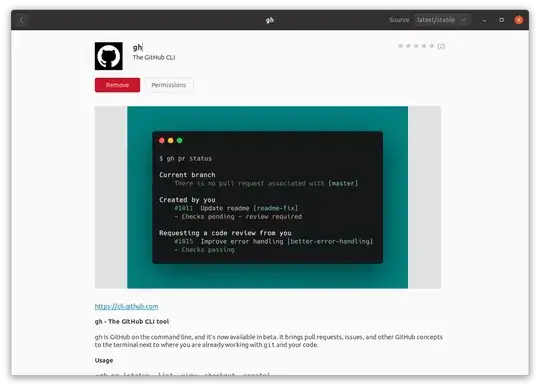

I experienced the same problem on 20.04 trying to get the github cli (gh) installed via snap to clone a repo over ssh. In the Ubuntu Software entry for gh, I needed to enable ssh-keys: allows reading ssh user configuration and keys. There is also the option to Access files in your home folder.
gh snap settings in the Ubuntu Software app
