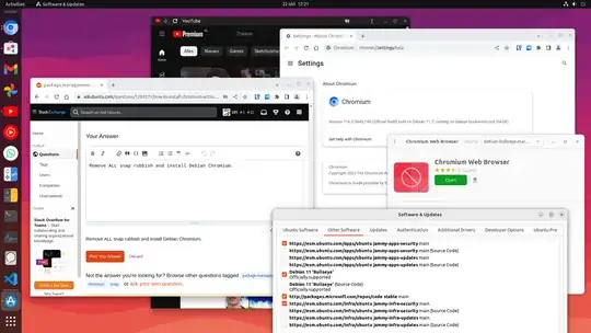

Here are the steps to get this working for Ubuntu 22.04 based on the current accepted answer. I did not edit existing answer, because there are too many deltas. SO to @pruflyos for doing the heavy lifting.
  1. Remove chromium packages (regular and snap):
sudo apt remove chromium chromium-browser chromium-browser-l10n chromium-codecs-ffmpeg
sudo snap remove --purge chromium-browser
  1. Add older bullseye deb sources (see Ubuntu codenames here), by creating /etc/apt/sources.list.d/debian.list with contents:
deb http://deb.debian.org/debian bullseye main
deb http://deb.debian.org/debian bullseye-updates main
deb http://deb.debian.org/debian-security/ bullseye-security main
  1. Add the deb signing keys:
sudo apt-key adv --keyserver keyserver.ubuntu.com --recv-key 6ED0E7B82643E131
sudo apt-key adv --keyserver keyserver.ubuntu.com --recv-key 605C66F00D6C9793
sudo apt-key adv --keyserver keyserver.ubuntu.com --recv-key 0E98404D386FA1D9
  1. Configure apt pinning. Create a file /etc/apt/preferences.d/chromium.pref with the following content:
# Note: 2 blank lines are required between entries
Package: *
Pin: release a=eoan
Pin-Priority: 500
Package: * Pin: origin "deb.debian.org" Pin-Priority: 300
Pattern includes 'chromium', 'chromium-browser' and similarly
named dependencies:
Package: chromium* Pin: origin "deb.debian.org" Pin-Priority: 700
  1. Install Chromium again:
sudo apt update
sudo apt install chromium
  1. Test:
root@<host>:~# chromium --version
Chromium 120.0.6099.224 built on Debian 11.8, running on Debian bookworm/sid
as another user
root@<host>:~# /bin/su - ubuntu ubuntu@<host>:~$ chromium --version Chromium 120.0.6099.224 built on Debian 11.8, running on Debian bookworm/sid
Note: This also works on AWS Graviton arm64 arch.

Remove ALL snap rubbish and install Debian Chromium. Install ONLY Chromium and not any Debian Updates. After installing Chromium turn off Debian 11 'Bullseye' in Software & Update > Other Software. It is not necessary, but if a Chromium update is available, turn it on again, but do not just update it. Go to the terminal and sudo apt update && sudo apt install --only-upgrade chromium. Then turned it off againb. You are now using chromium and not chromium-browser. You cannot use the chromium-codecs*. Around a chromium-codecs run via snap. If you first delete snap, it will be restored again. Netflix will not run, but YouTube (1080p @ 30fps) will run perfectly.
