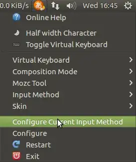

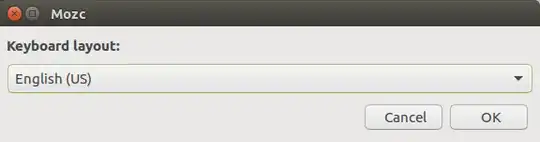

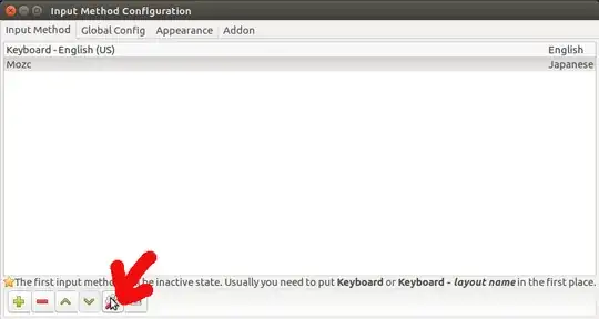

First click on this Mozc icon and bring
this window and click on the red arrow, preference button,
Pull-down the menu from Input Method Default to your favorite.

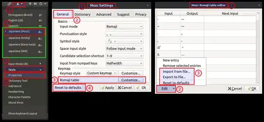

How to do (solution 2)
To do that:
  1. Click on Gnome Status menu (Gnome's top-left bar) > IBus menu (i.e. keyboard/input language selector) > Select Japanese Mozc input method.
  2. Again, click on Gnome Status Menu > IBuz > tools > Properties > Mozc Settings window.
  3. From Keymap section > click on customize button (second one, from Romaji table).
  4. Create new entries with your specific keys to binding the romaji-hiragana keys.
  5. If messed things up, click on reset to defaults button from Mozc Settings window.
See the screenshots about how to edit your ibus-mozc
