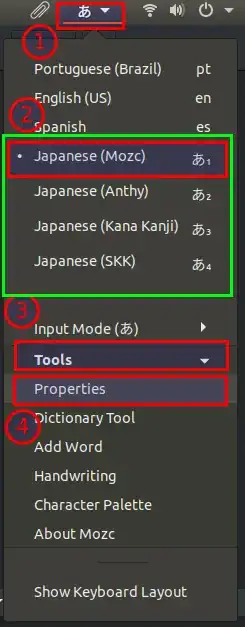

How is the input method configured in Gnome? (A Windows user just downloads and installs the Google software for comparison. It just works.)
First install: japanese language, one IMF, and one japanese IME.
After that, you only need to click on GNOME Status Menu (Gnome's top-right bar) > IBus menu (i.e. keyboard/input language selector) > Select your desired input method.
Gnome and japanese input methods
Or use the shortcut: hold Super and press Space.

To switch between japanese input modes (e.g. hiragana, katakana etc) is a important requirement. Each IME comes with their own:
  • shortcuts or binding keys to switch japanese modes.
  • plus that, has graphical submenus at GNOME Status Menu to switch between japanese modes and access its configurations.
