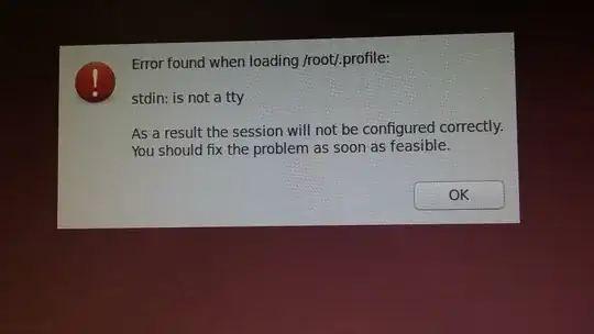

Logging in as root doesn't work but I do get an error message this time. Error message when attempting to login as root

Step #2: (fix root .profile)
  • log into the text tty with your username/password
  • type sudo pico /root/.profile
  • change mesg n || true to tty -s && mesg n || true
  • save the file and quit the editor
  • type exit to return to the graphic tty
  • log in as root and confirm no .profile error
