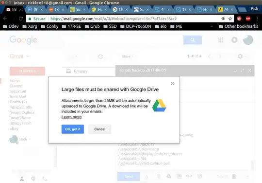

On gmail.com, I see this:
0.38 GB (2%) of 15 GB used
I have 20 GB of my 30 GB partition filled with Ubuntu stuff, but probably only 1 GB of important documents, so why not use this free cloud storage for backup?
Is there already a program to do this? I'll probably write one anyway but wanted to ask before I start.
I also want file compression and segmentation, because some systems have 10 MB attachment limits (like the one at work).
Thanks :)

May 6 2021 - Google has started scanning contents and rejecting zipped files
If they contain certain file extensions. It reports an error
without giving the filename. Solution is to use zip with
password protection emcryption. Filename is backup.tar.zip
zip --password daily-backup --quiet "$Filename.zip" "$Filename"
Attachment has to be base64 to avoid google errors: backup.tar.zip.64

When I first created a tar file (tape archive) using these two directories and tried to email them to myself I received this error:
gmail 25MB limit
gmail.com won't accept files > 25 MB
How can two directories of scripts written over 10 months be larger than 25 MB? On closer examination they are are > 190 MB. Whhaaatttt?
In turns out to be a single file created for testing purposes:
-rw-rw-r--  1 rick rick 191143744 Dec 23 17:27 log-gsu-gedit.tst
So delete this test file and rerun the commands:
tar -cvf scripts-2017-06-05.tar /home/rick/bin
tar -rvf scripts-2017-06-05.tar /usr/local/bin
The first command creates the .tar file using one directory of script files and the second appends to the .tar file using the second directory of script files.
The .tar file is now a more respectable size of 1.3 MB:
-rw-rw-r-- 1 rick rick 1341440 Jun  5 17:27 scripts-2017-06-05.tar
